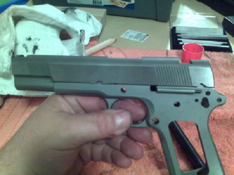

All my main parts are in and start up the build!I'm using a Fusion Government frame and a Foster 5" slide.This my first build for me and i got most of the info I needed to get started this website and others on the Internet. I did win a Jerry Kuhnhausen shop manual on eBay , but haven't received it of yet (going on 10 days now). I felt pretty confident to start it with out the manual and figured if i get stuck or nervous I would just put everything down and wait for the manual to help me fit the slide to the frame.
Using a slide/frame file from Brownell's , a few different grits of lapping paste and about 6hrs I had the frame and slide mated and sliding nice and smooth and tight .I added a few pics and any advice or constructive criticism would be appreciated.

Looks good to me. As always "measure twice, cut once" OOPS! wrong discipline. :wink: Go slow. Stop when ever there are questions. Doing good so far. :cool: Tracy

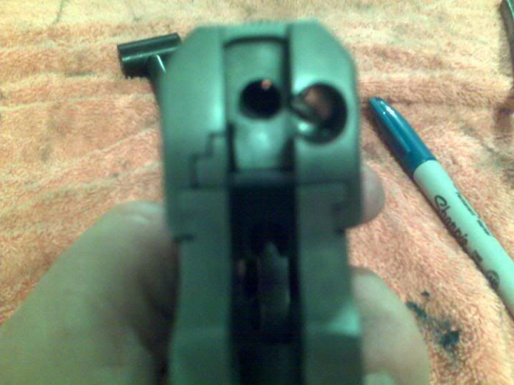

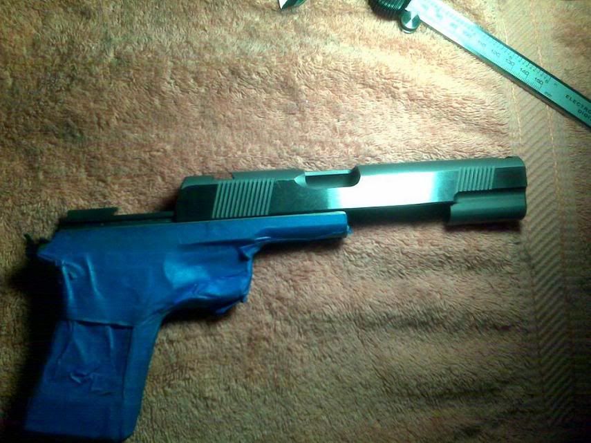

Discussion Starter · #9 · (Edited)
Some new pics. I have everything pretty much fitted. I need to work a little more on the beaver tail . I will have the rest of the parts to finish up by Monday.Can anybody recommend a decent do it yourself finish ? I prefer a matte black.

Some new pics.Almost done just a few loose ends to tighten up.I just have some binding up when round get fed into barrel. I think i just have to ramp the barrel a little more.
Looking good.
