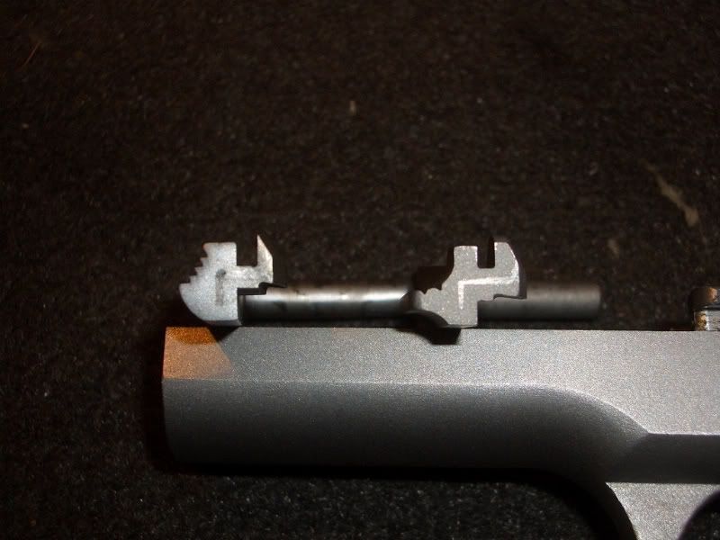

I have an extra slide stop from Fusion that looks like it is for a 9mm. The bottom shelf (contact point for the magazine) on the new slide stop is lower. After a little investigation by my gunsmith, he determined that it looks like a 45 cal slide stop was originally fitted. I have not yet been in contact with Bob to confirm demensions, but when we install the new slide stop it operates correctly locking back on an empty mag. But, the slide jams a little. This new stop is .002 lager diameter pin and we are going to have to replace the link and recut the bottom lugs. Such is the learning process. :thinking:

First off let me say that I called Bob this afternoon and explained my problem. He took the time to explain the situation and what I needed to do to fix it. He needed 5 minutes to describe the fix, it took me 20 minutes to do the work. On the left is the original slide stop and on the right is the better part.
The pin on the correct stop was .002 too big causing the top lugs to jam into the slide, so after correcting that the way Bob told me to, everything works the way it should.

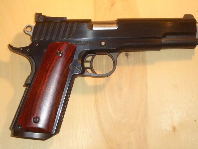

Here are the promised photos:
My plan is a high polish on the slide and frame flats, then blue the entire gun. Range report tomorrow.

Bud,
Sorry I was not more descriptive. The firing pin stop on the left appears to be a 45 acp slide stop. The magazine follower would not engage the stop, the stop did not extend vertically far enough down. The slide stop on the right, being slightly taller does engage the follower. The problem was that the pin that traverses through the link was .002 inches too large on the right pin. This caused the upper lugs to lock not just engage the slide lugs. It would take an excessive effort to unlock the the slide, allowing it to move aft. By reducing the radius the upward movement of the barrel was reduced allowing correct engagement of the barrel / slide lugs. All is well with the universe...my Fusion works as advertised. :smile:

Put another 100 rounds through the weapon this afternoon. There were zero failures of any kind and no slide problems. The accuracy was VERY consistent (more so than I :nuts:) and I was getting a 3 inch group at about 7 yards. Any "flyers" were my fault and I felt the push or jerk as I squeezed the trigger and knew it was going to be off.
I went back to my gunsmith for a little finish work on the thumb safety and it is as smooth as silk:shades:. We also did a little more trigger work and have the trigger down to about 3 lbs 14 ozs, no creep, and a crisp break. :dancingbananna:

finished the kit
I deceided to blue the gun just to complete the full circle of "gunsmithing" my first kit. It took about three to three and one half hours to polish the flats on the slide and frame before I blued it. It was a little tight after it was blued but seated itself quickly. The gun it FANTASTIC and a real tack driver, I could not be happier.
