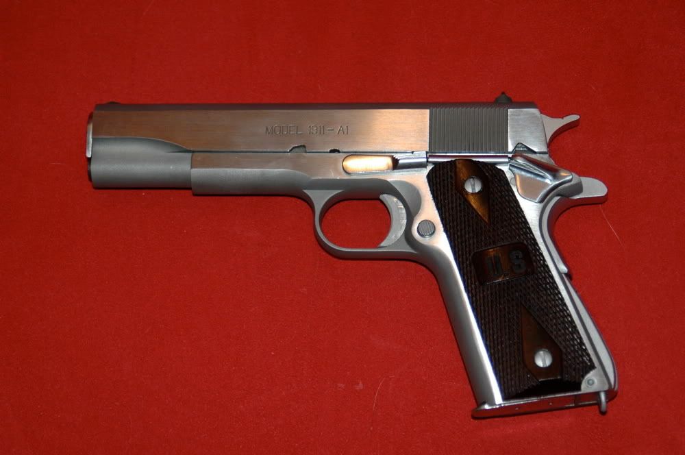

I picked this up last weekend for 475.00 and I think it's going to be a range gun that I want to trick out a little. My question to those in the know is, what should I be looking at doing to this gun aside from some real sights? Also what company makes the best fitting parts, or am I fooling myself thinking I won't have to do much fitting. I'm fairly capable with tools but I'm no gunsmith. I would also like to find some good 1911 gunsmithing DVD's to learn as much as I can.

Basically I want to really learn the 1911 and use this GI as my canvas. I thought about getting a RIA for this but I really don't have that much more in this Springer and it's stainless. I think an ambi safety and extended Beaver tail would be a nice start.
Well you can go drop in on beaver tail it will still take fitting S&A makes a .220 Radius which you will need for springfield or you can go with a ed brown , wilson , Fusion that you will have to grind the frame for ..
Ambi safety will need to be fitted no matter what but they are not hard..
you have to change the hammer to go with a beaver tail

As an alternative to the beavertail you could “bob” the hammer. This will shorten it just enough to eliminate “hammer bite” (this is the problem that was fixed with the beavertail) but I would recommend shooting a couple hundred rounds first to see if it is even needed. Whether or not you get hammer bite, and how bad it is, depends on you hand size and how you grip the pistol.
Aside from that, for me anyway, the sights are a must along with an extended thumb safety. I would also look at a fitted barrel bushing it is not accurate enough out of the box.
Personally, that’s about all I would do.

I took the G.I. to the range this weekend and put a hundred rounds or so on some steel plate. What a nice shooter for a bone stock gun, I really enjoyed shooting it. I had no problems at all with it, no FTF's or Stovepipes, not even hammer bite. I will be keeping this one.
