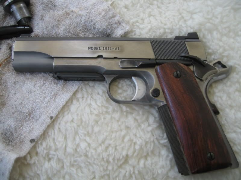

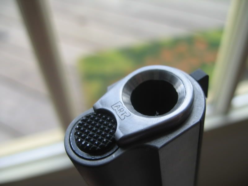

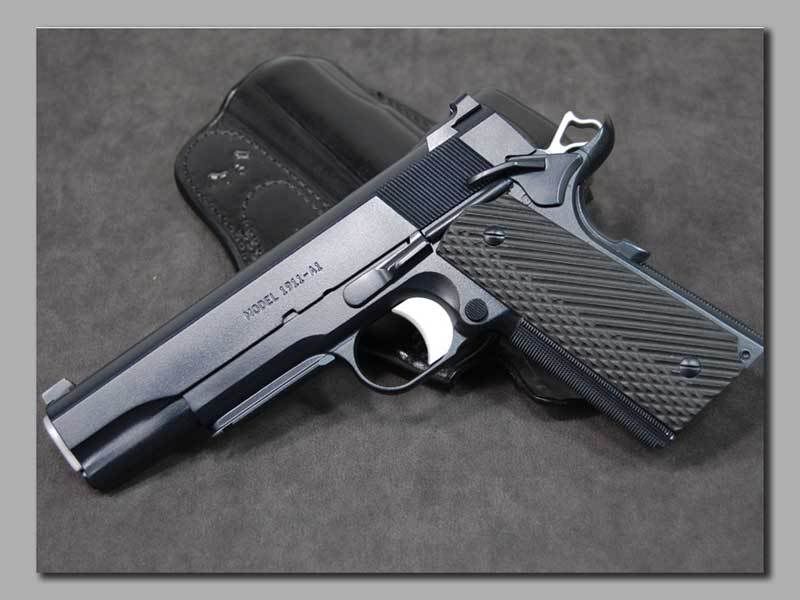

[FONT="]Okay, now for pictures, some were taken by Dave, some by me. The first ones are a couple before pics, and comparison pics showing what the muzzle looked like before Dave fixed it up for me.[/FONT]
[FONT="]Enjoy! [/FONT]
