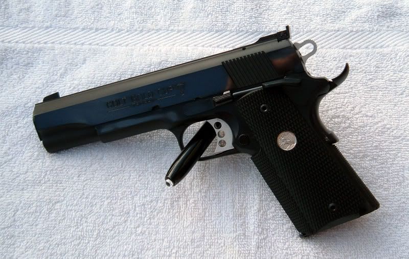

I don't have pics as I don't have the gun any more but I put one in a lwt xse one time and it fit much better than the ducktail that came in it.
oops, I lied here's a pic:
Thanks: That looks like a great Fit :cool:
I just installed one in my Colt/Essex build. Like most parts I had to do some metal work on the GS to get enough clearance on the frame. Only on the sides. It looks fine but does not have the close fit of one the frame was modified to accept. I like mine fine. Rob
If it would not have fit so well I would have cut one in. I am partial to the ed brown high rise ones and have done mostly those. That one fit so well I did not bother. I cut the bobtail in that colt along with some other stuff.

I used one on an XSE I used to own also. Looked and worked great. I don't have a problem persay with cutting the frame for a BT. However, if you have an option to avoid doing so. There is no other way imo.
BTW, awesome looking Bobtail Jerry.:notworthy:
Thanks Justin that was the first bobtail I ever cut in, did a bunch of other stuff to it also. Sure wish I still had it.
This is what it looked like finished.
http://1911auto.org/forum/showthread.php?t=1557
One day I will get another xse and di it again. Perfect carry gun.
