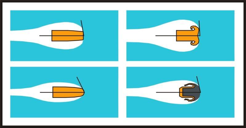

    Bullet life in game animals is about two revolutions and this pic gives an example of cavitation levels based upon bullet construction;

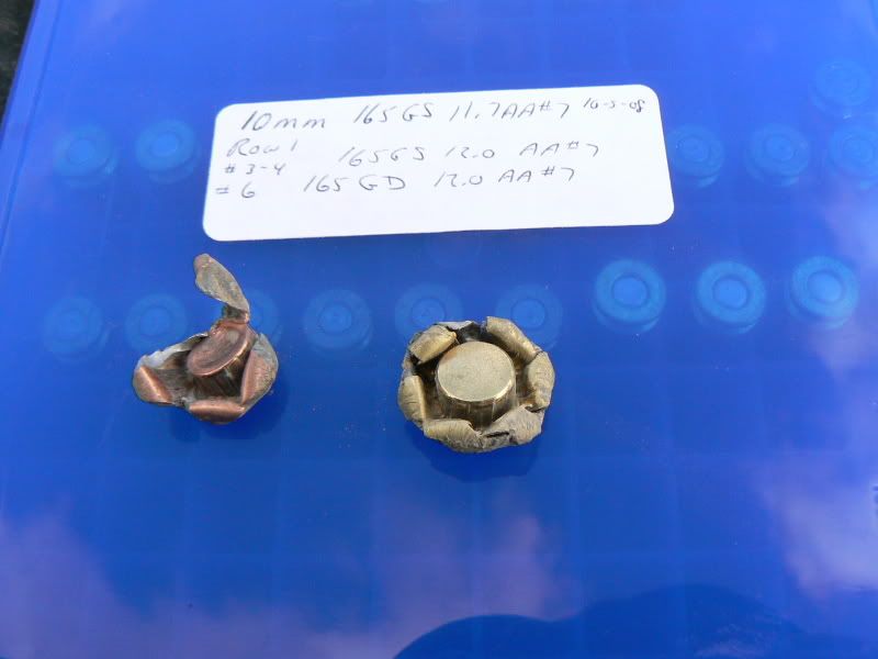

    Here's an example of .40 S&W bullet designs after penetrating one water bottle and terminating in caliche clay (like cement). Both the 165gr Gold Dot on the left and 165gr Golden Saber (right) were loaded with 12.0grs AA #7/10mm. The GS retained its original weight and showed optimum expansion; however, the GD weighed in at 142.0grs with the forward part of the bullet blown off.
